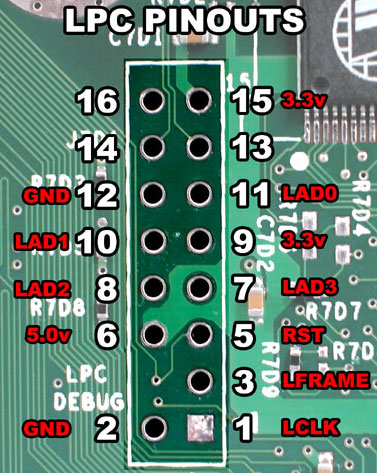

Are both leds on the x3 lit?
Bytecode
Jul 22, 2004
80
also, check the pins where the switch plugs into the x3. A lot of people have bent their pins by trying to insert the switch cable upside down.

There should be two blue lights on the x3. One for the 3.3v and one for the 5v.
Which one is lit?
HoBoZ
Sep 24, 2004
874
bc-tz.com
The x3 has to have a 5.0v supply. Check pins 15 and 9 with a mutimeter.
HoBoZ
Sep 24, 2004
874
bc-tz.com
I'm sorry the pins #9 an #15 are for the 3.3v. :eek:
Pin #6 is the 5V

I guess there wasnt enough solder on the joint... I re-soldered it and the bios came up! Woo!
