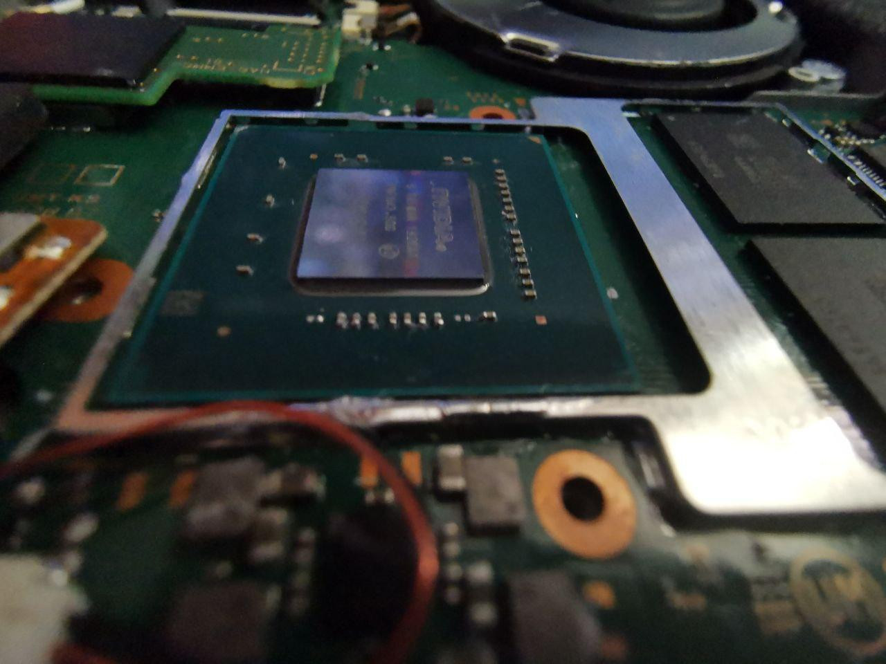

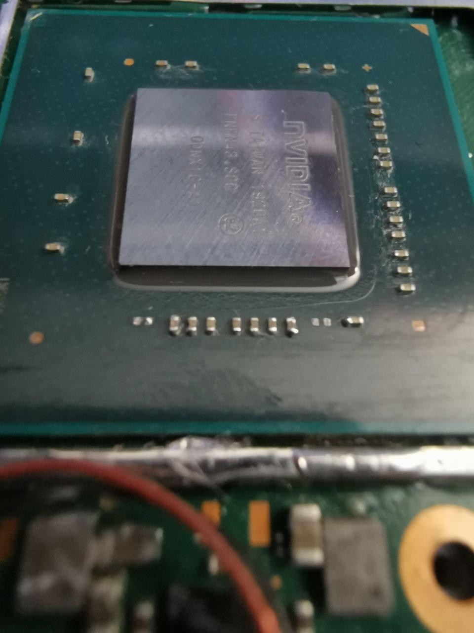

hello, as it happened to me both on sp1, that on sp2, I wanted to share the experience and ask for opinions (unfortunately I had to remove the left core that was ruined but the switch however the switch continues to work, I tried to play a little Mario Odissey and it went smoothly), my situation is this:
My question is: wanting to replace the caps, the sp1 is equal to the 'sp2? (1uf size 0201 6,3v) , since the switch works and I ordered another sx core, would it work by soldering the sx core directly on sp1 and sp2 without caps? (I’m afraid to solder the caps you need someone really very capable considering how small they are)
