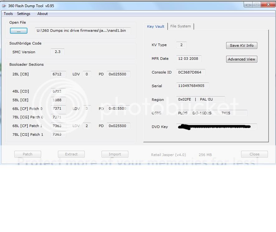

The saga continues with the Jtag Jasper
sorry, this is a JTAG and not an RGH.
Flash xellous back to your console.
Take the image you have built for freeboot and use it in multi_builder together with your CPU key to create a clean nand image.
Flash this clean NAND image to your console and make sure it boots. If so, take that clean nand image and use it to build a new JTAG image with your specified wiring.
yes - if xell is booting you know that the jtag exploit still works.
You want to build a RETAIL NAND from your freeboot one.
Flash this to the console and make sure it boots.
Finally take the RETAIL NAND you built in multi_builder and use it as the source (nanddump.bin) to build a JTAG NAND.
seanr28
Mar 7, 2004
1,203
ok, well I have it working anyway, I created an new jtag image using my existing freeboot one, so that it keeps the smc, then flashed this and it now works, even after leaving power off for a few minutes!! Have fully tested it now, and its definatley fixed!
Thankyou again, will leave it alone now!
