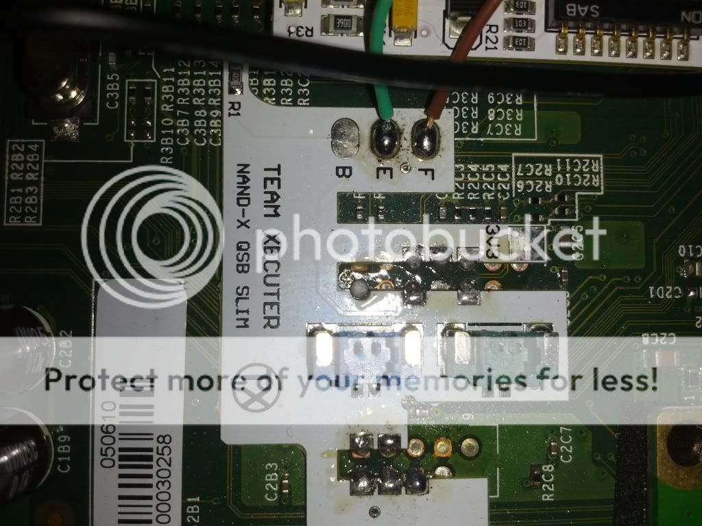

I've looked at every thread here and tried I'm pretty sure every length and method. System just quits glitching and fans rev up and random times. Attached are photos and Jrunner log.
Note* Using an old Nand X slim QSB. Not sure if this is a problem or not. I ran the 5.5v to the underside of the board to get power.

post out dont look so hot from pics.
Will look in to it.

Your post out pad is burned/lifted, you will have to use the topside alt point or the tx corona post fix adapter (yes it works on trinitys too.....) with that being said and post out the way it is does your dgx green light blink?
Personally i use the black ground wire (11cm) for cpu reset and a 90cm post out wire.
Looks like 2 qsb points are bridged, below the circle TX logo...

Tried that wiring method as well. TX not bridged. Must have been the angel of the camera. Yes I get the green light blicking, beleive it or not, thats how the pad looked from factory. Will try the post fix adapter though
Yes
Ok, i bet if you goto solder another wire to that post out point you will find it hard to do. If you don't wanna use the alt point or post fix adapter and your post out wire is working now, leave that wire soldered to post out and solder your new post out wire onto that one that way you don't risk ruining that pad and HAVING to use an alt post out.
The post fix adapter just makes soldering easier, or necessary if original point is ruined, ts not gonna help you glitch any better than the original post out point.

Cold solder joint on the damn qsb is the culprit. Just had one hell of a time writing the orig nand back. After an hour or more of failed attempts I found a cold joint on the QSB.
At this point I don't even wanna glitch it lol.
