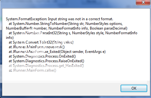

It created an image but there are two concerns I have:
1) After making the image J-Runner gave this error:
I am assuming that this is just because fcrt.bin isn't real so this is nothing to worry about. The log did give an error about fcrt.bin which is expected.

nvm the error
as for the kv shouldnt be type 1, thats weird

nvm the error
Ya I thought the error was ok, it is the KV that bothered me.
I can upload the files if you or anyone wants, but its not like anything can really be done lol
I guess I just have to go for it.
