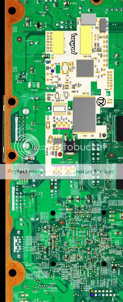

Hi guys my demon was installed perfect and all points were strong, however just in the middle of replacing my coolrunner A for the ck3 lite. The little circuit board that attached to the coolrunner from the demon i had lost so wired all the points to the demon, now the ck3 lite had that installed i de soldered the un-necessary wires, however without touching the tx point it wobbled loose and broke away. is their a known alternative point for the tx pad? its the purple wire or point 3 on the pic below.

you can see the trace for that pad, just scratch off the top surface and solder onto the trace

Can that be done like? ive scraped away and soldered to trace lines before just havn't attempted it on the tx products as it was a white colour, not that make's much differance, if i scrape it away will it expose the shiny trace line?

You can trace the pad back to the pin on the IC and solder to that - this would be easier in my opinion.
Thanks will prob do that will let you know if it fixes it

he is right though, you know....you wrote "my demon was installed perfect and all points were strong"...no offense, but the soldering looks like sh*t

....damn the wiring looks worse close up than to the human eye :facepalm:
Need a few more of these.:facepalm::facepalm::facepalm::facepalm: That is some seriously bad soldering. If you are having that much trouble soldering to a huge pad like that then you should find something to practice on, a lot, before you attempt the repair. Better yet find someone willing to fix your mess before you completely destroy it.
