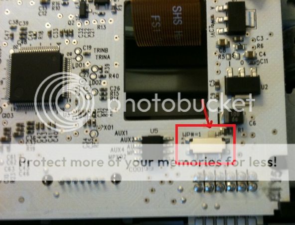

Because I cant fix it my self but could easily be fixed by someone else it has a spot on the pcb where the old pcbs had the unlocked switch and I was wondering if I could buy the switch and install it on to my pcb. I basically need a nother way to enable and disable the write protection since I have no switch to flip
13,721
I couldn't tell you where to get a switch, but this is what it looks like:

Yea thats what I was talking about I wish I knew where to get it because it seems like the only way to fix it. Modchipcentral said they would replace it if I showed them a picture first but I tried to fix it with some glue and stuff so I thought think that will now but I wouldn't blame them. Sorry that the pics are blurry I took them with my phone. The first one shows that the pcb is has a broken wire that can be solderd back but the white wire is barley hanging in with some glue. The second pic shows that there is a spot for a unlocked switch.

you can wire in any switch, just wire to the pads.
small SPDT switches are easily found in MAPLIN etc, and wire to the pads using kynar wire.
but the fact you tried to glue a wire instead of soldering makes me think you lack the basic skills to fix this issue.
send it to a pro to fix or replace the PCB before you wreck it.

You dont even need a switch, you could just bridge the connection with a piece of wire, one way to unlok and flash it and the other way to keep it locked after flash (i dont think there will be any more FWs for D4S anyway so dont worry about the switch). And dont try to scam modchipcentral, if you broke the PCB then its your fault and should not be fixed on their cost!
