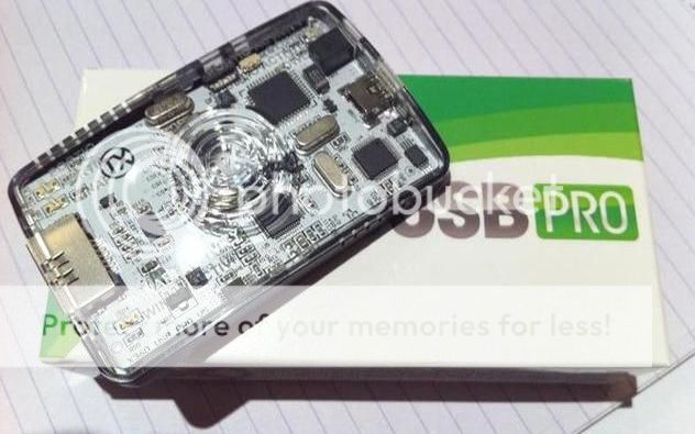

Xecuter's X360USB PRO is the world's first SATA to USB Mass-Storage controller that not only enables WINAPI over USB, but also PORTIO. This powerful all-in-one converter can be used with any software or hardware that uses these signals to work. Designed by Team Xecuter in conjunction with the experts at Team Jungle, the X360USB PRO adapter is the most advanced WINAPI/PORTIO to USB adapter ever created. One stand out feature is that you are now able to connect all Xbox 360 DVD drives to any PC or Laptop for the first time simply by connecting to a USB port.
No more struggling with specific SATA chipsets or issues with awkward operating system setups!
Now tasks such as repairing your Xbox 360 DVD drives firmware or upgrading your broken DVD drive to a new one without the expensive fees charged by the manufacture just got easier than ever before. Whether you are a beginner or advanced user, this multi-use Mass-Storage controller is an essential addition to any toolkit.
ONLY $49.95 @ XCONSOLES
just sayin.....
