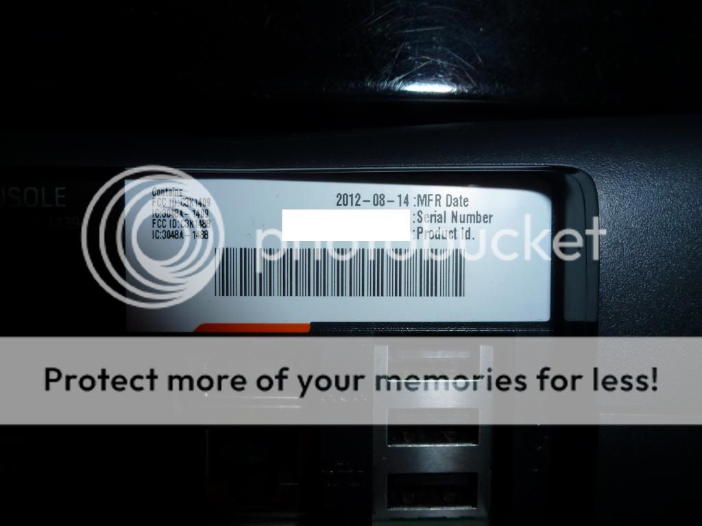

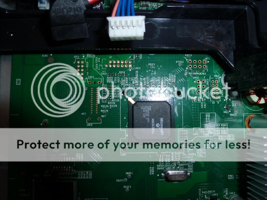

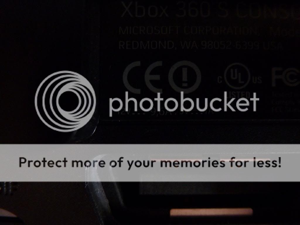

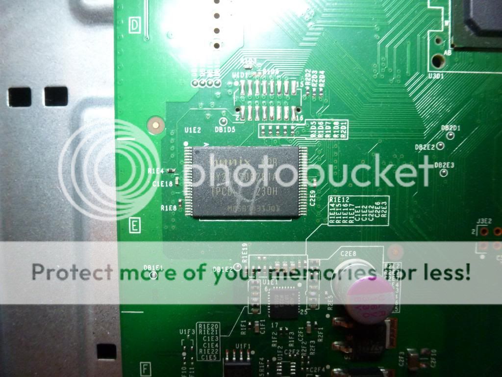

Hi all, Iv'e done this install on a phat when it first came out but never done it on a slim and my mate wants it doing. Here are the pics from his console Could you identity if it is a Trinity or a corona? Checked the identify chart but confused. And also what chips will i need? e.g.
12v 9.6A (bit dark the picture)

Thanks well got console apart and from what i can see and from what i read on the guide you kindly supplied me i think its a Corona V3. But would like you guys to double check for me. If it is i beleive its still glitchable and able to use demon? I did come with a 250gb hdd too so seems to look like the V3.
Feel free to save the photos and zoom in for a better look, you can see it better zoomed in.

It's hard to tell from the pics but I'm thinking its a V1 if not then its a V3. You can definitely add a demon to it.

As Krafter said it is definitely Demon-Able. Is Post Out Missing? Pictures of the differences are in the Motherboard Revision Thread. I will find it and edit my post.
You must take the X-Clamp off and remove the Heatsink to be able to tell. You might be able to shine a light under the Heatsink from the DVD Drive side. Towards the front on the console you will be able to see if these traces are there or not.
If the traces are there, It is a Corona V1.
If there is no traces for the Post_Out it is a Corona V3.
If it is a V3, Everything is still good to go, You just need a Post-Fix Adapter and a different type of CR3 Pro (Fake Post) if you want the most reliable chip.
Once you find out the correct Motherboard Revision, You can follow the correct guide and you are good to go.
It is close to being a V3 Corona, Manufacture Date Wise. I have a Corona V3 that is just a month younger than yours. But you have to see if the Post-Out is there or not to be sure.

Thanks please do and all bits i need as looking through some Team xecuter guides for demon and glitching these consoles their are loads of chips to consider when hacking. 4gb ds card r/w chips chips that go around the cpu chips that sit near the x clamp. As you will understand i dont want to start ordering parts until i know exactly what i need and what i dont. But yeah if you can get back with if its V1 or V3 and what ill need that would be amazing. But again looking at the motherboard i would say its more v3 and i think the manufacture date may back it up being built in August 2012

As I Stated Previously, You must lift the Heatsink to know for sure. If it has those traces I posted in the picture above, It is a V1.
If not it is a V3. After you know that you know what you need to order.

Easier to just check post_out and GND for continuity than removing the heatsink.
Yeah I know but I figured you can't be wrong by seeing it for sure. I didn't want to chance it if the OP didn't have a Multimeter. Seems like a rare commodity nowadays.
