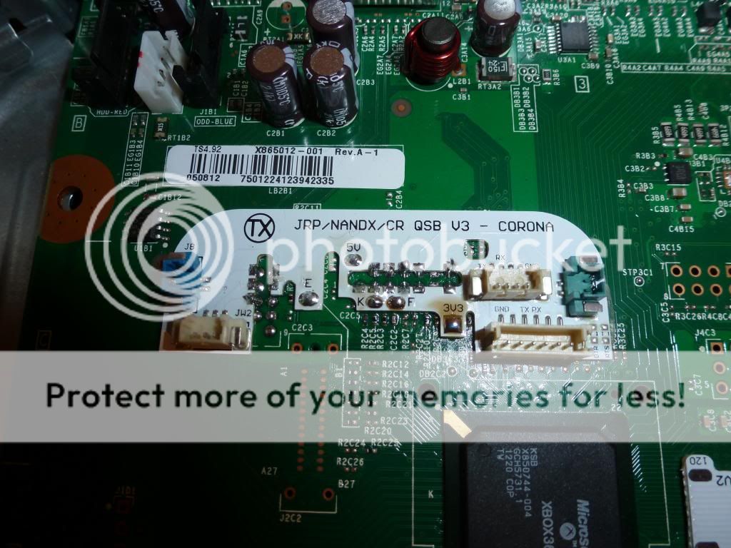

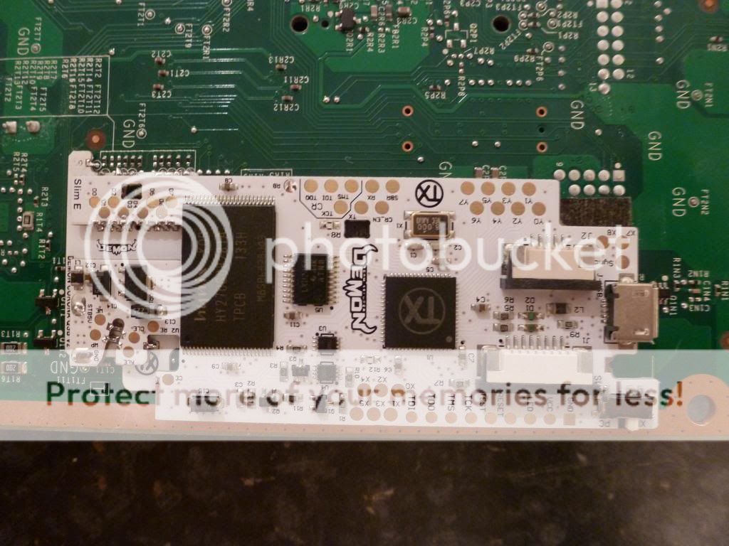

Thanks for your help guys got the stuff yesturday and done most of it no so far so good but those solder points are small and so close to each other! The hardest part was the demon and upgrade board merging those together. So now coming to the end of the install i have a few questions:
1. With the demon setup different to the other slim consoles having the extra pcb attatched and not being able to solder the big point next to the micro usb port does the wiring locations run the same as the trinity or is the wire locations differant on the v3 console?
2. with the cr3 pro installed do i insert the demon squere control bord to the falk pins on the cr3pro and do i wire the cr EN port from the square pcb to the coolrunner? or does the cr3 pro and the demon control this function via the provided ribon cable?
3. Once everythin is installed. I still havnt dumped the stock nand, decided to solder everything on first then dump the nand from the mini usb plug on back of console using j-runner ?
