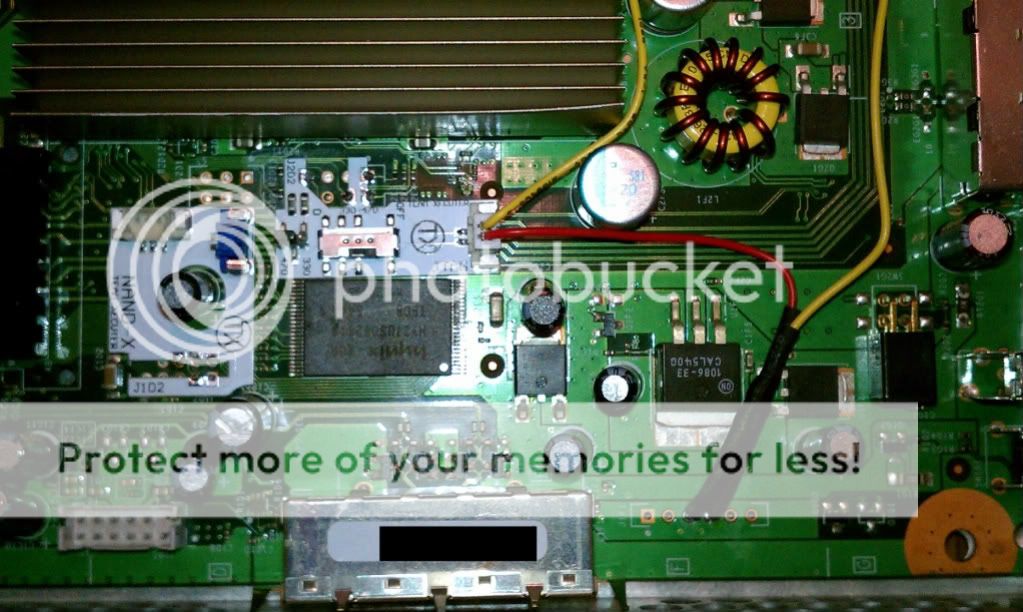

Okay, I had someone on this forum do a reball and the Jtag wiring for me but apparently I was missing one of the QSB for the Jtag so he used the falcon wires instead as in the picture below.
I trust this person(since everyone else does) but he never confirmed it through my PM. So, I'm coming here to the other experts for your confirmation that this will work on a Xenon motherboard.

I'm assuming the yellow wire is just looping around the capacitors because of the length of the wire
Are all those solder points connected on the QSB's if they are! power her up she should work

What do you mean installed correctly? I've never soldered before but they connections look decent from my angle.
I can try to take more pictures if you like...
EDIT: Well, I can't get good pictures using my phone of the soldering.

I'm gonna go ahead and try the nand. I just don't feel safe with the Jtag. I feel like I should have someone solder the other QSB on because using just the two wires scares me.

Yes, they look like that. Only thing is, there are a couple that 'look' like there isn't as much solder as the others but seems like it is getting contact.
There aren't any separate solder connections touching together if that is what you are asking.

I think I'm going to have my buddy solder the other QSB on. I don't like using the two wires since that is supposed to be for Falcon motherboards and not Xenons.
