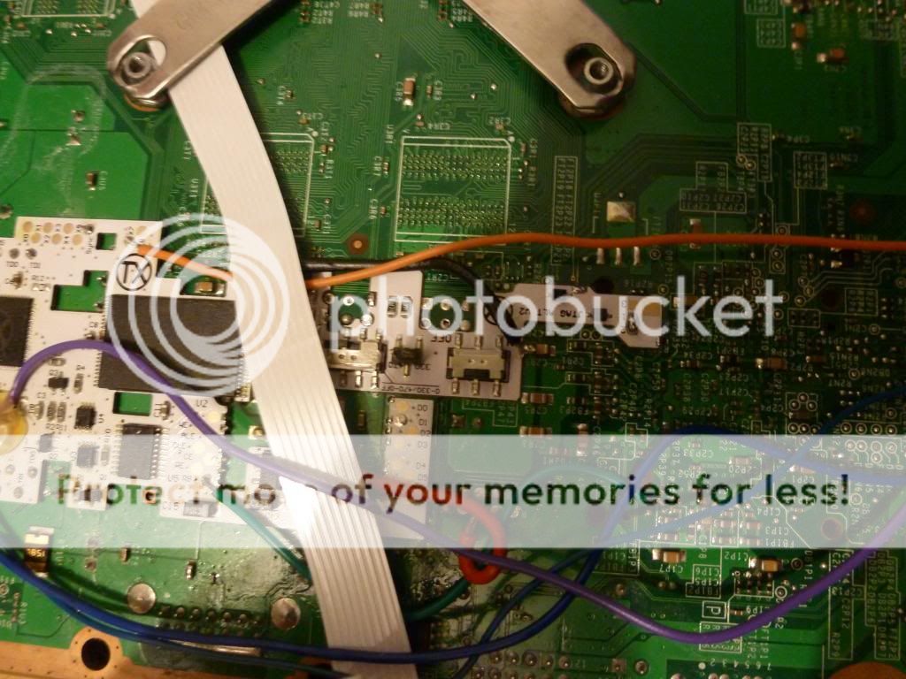

Hi im back this time my own console, Had the cr3 lite and was unhappy with boot times overall. Installed the R-jtag accordingly to the tutorial as this is just an upgrade to improve glitch boot times. Here are my setting for all the chips from the starter pack:

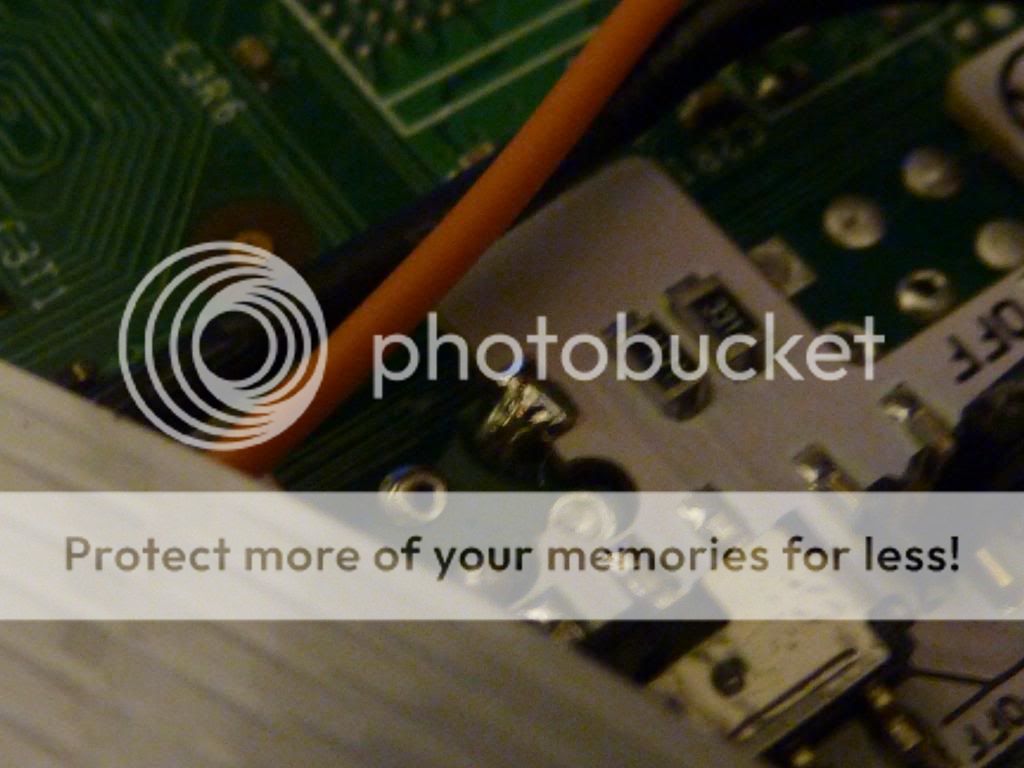

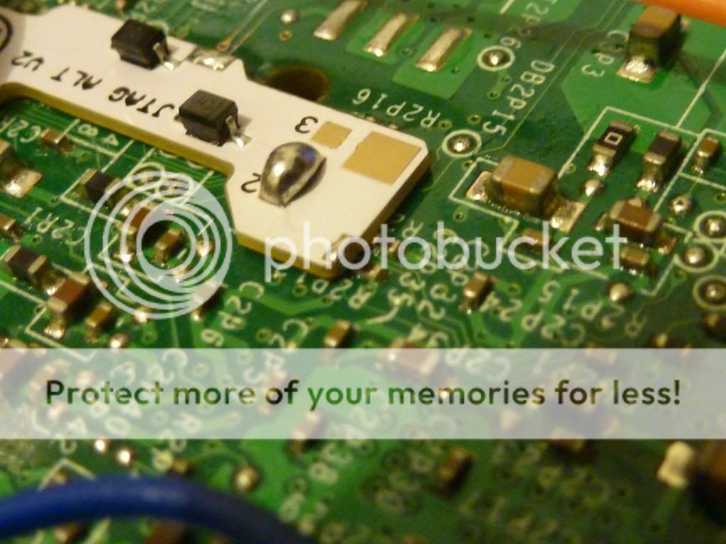

JTAG v2 board - 470ohm jumper set, 2 way switch is on, three way switch set to the centre, points 1 and 2 bridged

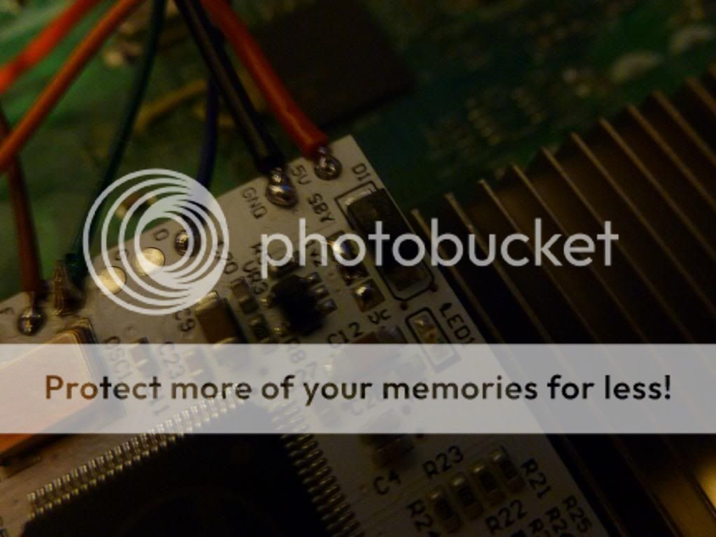

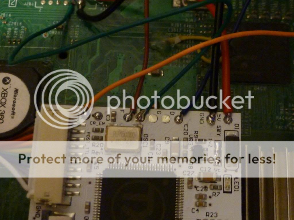

R-jtag glitch chip - Dip 7 on and dip 8 off, Dip 5 on only no combo, 1.2v connection bridged (see pics)

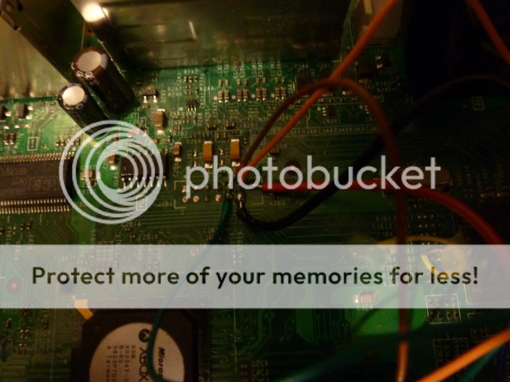

cpu_rst - from point D to side of R8C2
Before testing I erased the nand image off the Demon and just wrote the stock nand to it so that when i boots i know it will go to xbox dash also the old rgh2 files were on the demon nand and wouldn't work with new setup. However my problem is the console glitches and in most cases only takes 5 glitches to work, but as soon as it completes the glitches it goes to a RROD with Code 0022 which is GPU Error / GPU Overheating . Strangely enough id you turn dip 5 off and just have dip 7 running the RROD is 0010. So why would my console not boot and just give RROD? On the demon i de soldered the sync wire so i could get error codes and the orange wire is still soldered to the demon so cant do the rater test until i do. Also it stated the nand R/W cables must be connected to the J programmer in order to shutdown console, i did a wire install so do i need to re install my nand -x wires direct to do this or is their another way.
