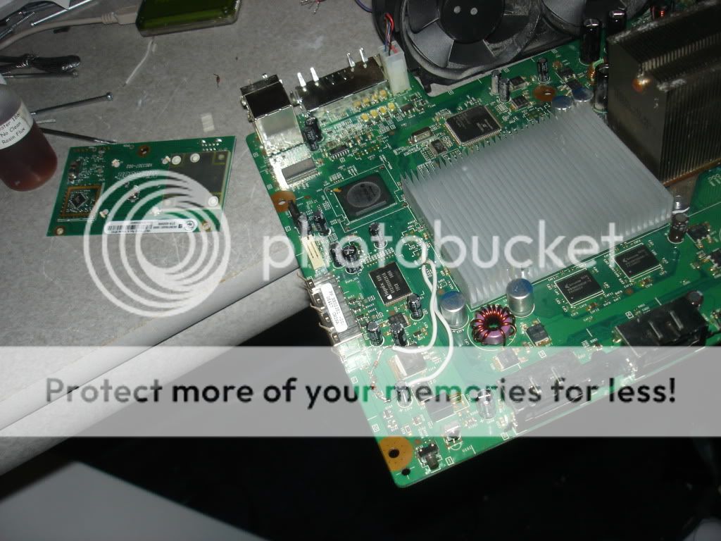

hi again , Today I am trying to jtag a xenon motherboard with 6717 dashboard and a CB 1903 , I managed to get my xell CPU key and followed with 12611 freeboot but i get a single green light and no picture nothing also tried xell and nothing so i install the virgin nand back and it works but freeboot wont any ideas?
oh, there were no bad blocks 3 out of 3 dumps all matched and i am using the 2diode jtag config

mafia 5k, try recompiling freeboot however I don't know if this will make a difference considering that now even xell doesn't work. Recheck the jtag part install, if using QSB then try different resistor settings and if using just standard diodes then try replacing them.

manwithoutname ,I dont know , I swapped out the diodes and recompiled freeboot and got dash working fine, :p Im wondering if it was the diodes or the freeboot nand hmmm...
sean, Thanks but you asked about the hdmi wiring and im jtagging a xenon using 2 diodes like i said from the beginning, I didnt mean to sound like a total ass sorry bro;)
here is a pic of the finished jtag"
