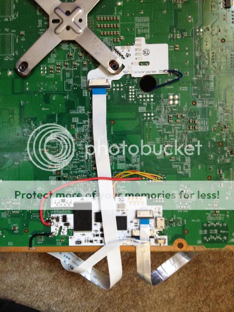

Not sure where to start with this one or what the problem really is but here goes.
Trinity with Demon and CR3 pro
Problem:
Console works fine with instant - 5secs boots. Every few days i will unplug the console to use my phat for online.
When i come back to the Slim it has no life at all on rgh nand. No lights when powering on, Don't turn on at all with drive eject. When i say no life i mean nothing at all ( no lights, no fan, dvd drive don't open) The only things that do work is sonus and there is also a RED light on CR3 pro but it stays red with no other lights.
If i keep messing around and unpluging the console and trying to boot it after a few hours it will suddenly power on and work fine. Seems then it will work fine for a few days and boot every time with no problems till i leave it standing again.
Stock boots fine no problems at all.
Install was done from Staff member and looks mint. Messaged the staff but they maybe busy and i have only a few days left before my internet goes down (moving house)
Anyone got any ideas please.

Sounds like an issue with the Demon connections, out of interest why do you not use this console for live as it has a demon.

Sounds like a cold joint somewhere on the demon, I would get it back to the guy who did it to check it over. Probably only needs a few of the points re-touching to sort it.

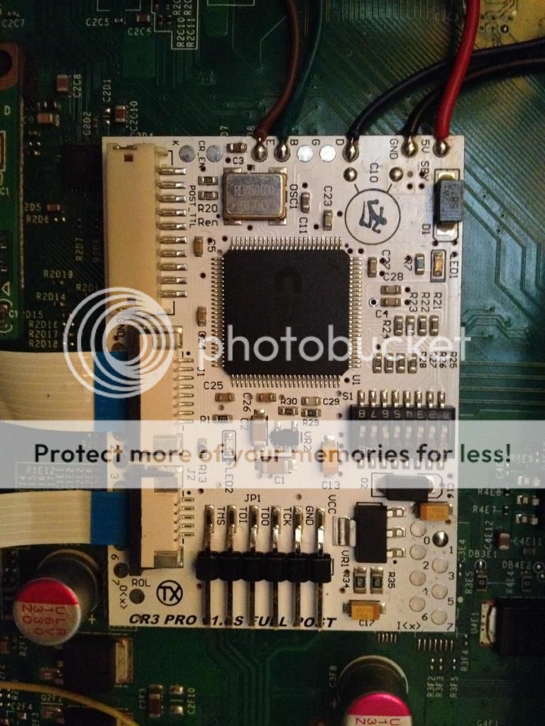

Found the problem with your console m8, the connection D1 had a bad connection all working fine now.
