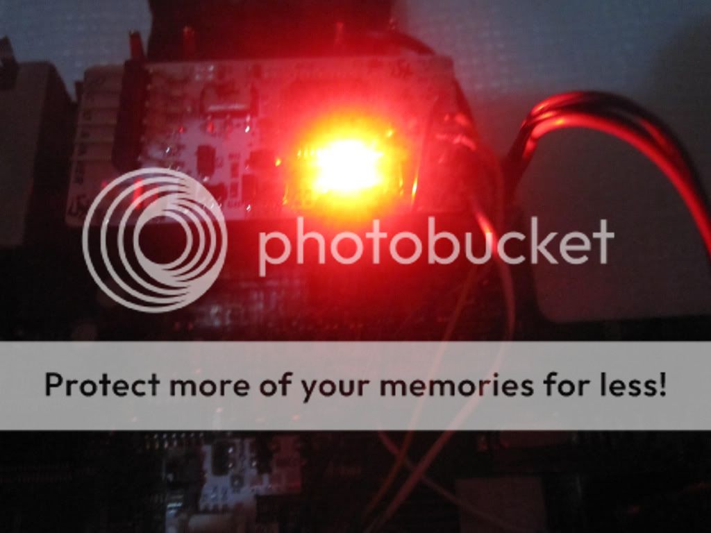

Successful on booting Xell Reloaded w/ coolrunner & on the last part of glitching my falcon phat.
Freeboot flashed to the nand
I shut down the xbox & unplug the power chord after 30 seconds plug it again & press the power button. My problem now is it wont glitch the coolrunner has red light & the green light blink every 5-7 seconds the screen is in black nothing you can see. So what I missed? Did I flashed freeboot successfully?
But every time I press the eject button it glitch & Xell Reloaded boot.

Seeing that it falls over at that stage I'd say yes, It's glitching if the green lights flashing odds are you need to rearrange your wires on the bottom of the board. Unless you've mucked up the freeboot side of course.

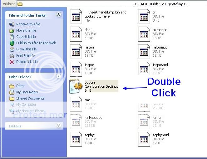

Sorry for the late reply I've print screen what I did so you can see what I did. I'm using Multi Builder 0.7

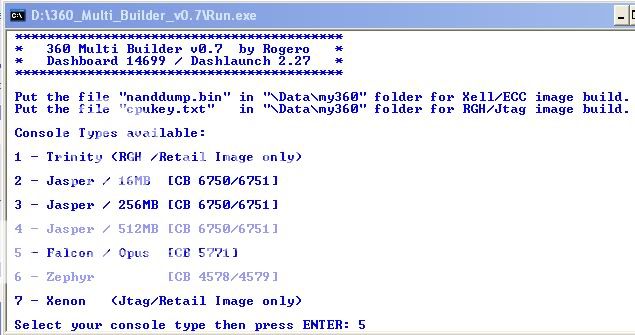

I already get the key so I put cpukey.txt into \360_Multi_Builder_v0.7\Data\my360\ folder. Choose number 5 because I have Falcon

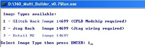

Then after that this page appears so I choose number 1

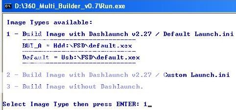

Another page appears so I choose number 1 again

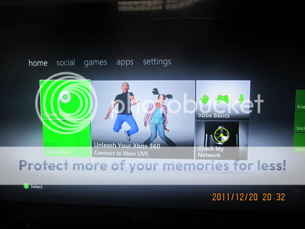

After that this page appears

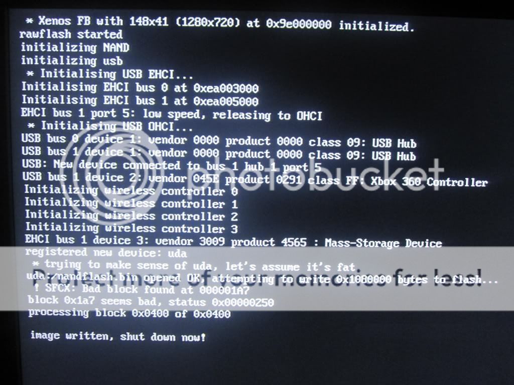

Then the last part is this I copied nandflash.bin & xenon.elf to the root of USB Stick.

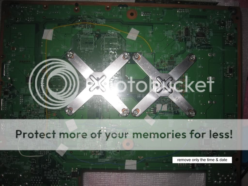

BTW this are the pictures of wiring at the back

Try routing the blue wire along the same route as the green wire on the back of the board, that how mine are on my jasper - boots every time in a few seconds

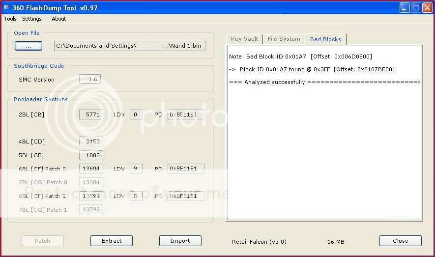

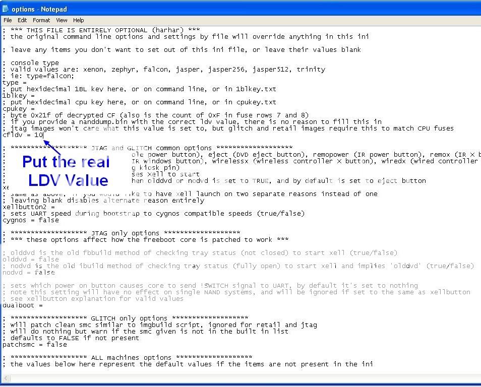

aclark20 is right!!!! my LDV value not matched!!!
I count the f & the total is 10 the real LDV value

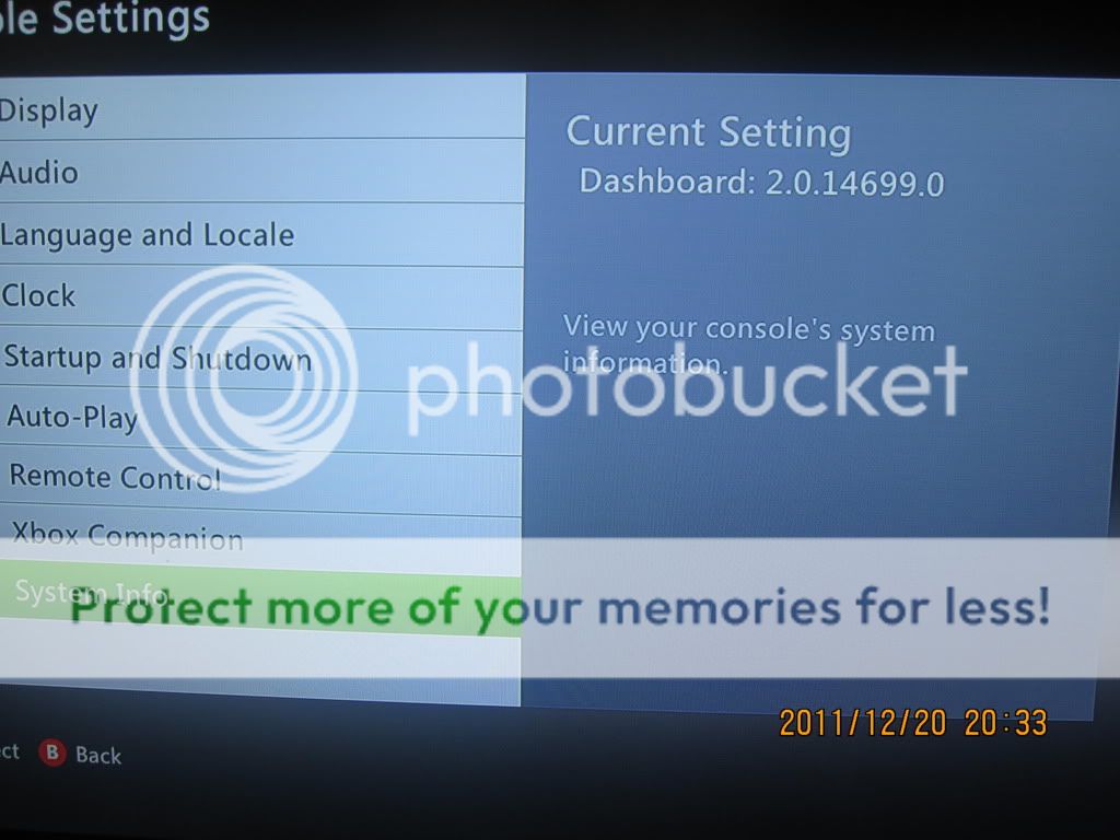

As you can see here my LDV value is still 9 just because I dump the nand when my system is still verion 13604
as you can see here
I revert back to stock the nand to be able to update the system to 14699 because I used the newest Multi Builder w/c has 14699 build after that I forgot the LDV value increased by 1 because of the update. I rebuild again the image on Multi Builder & find the option to be able to change the real LDV value
After rebuilding the new image & update the nand in Xell Reloaded after that turn off & unplug the power chord after 30 sec put it back again & viola my Xbox RGH falcon glitch!!!
