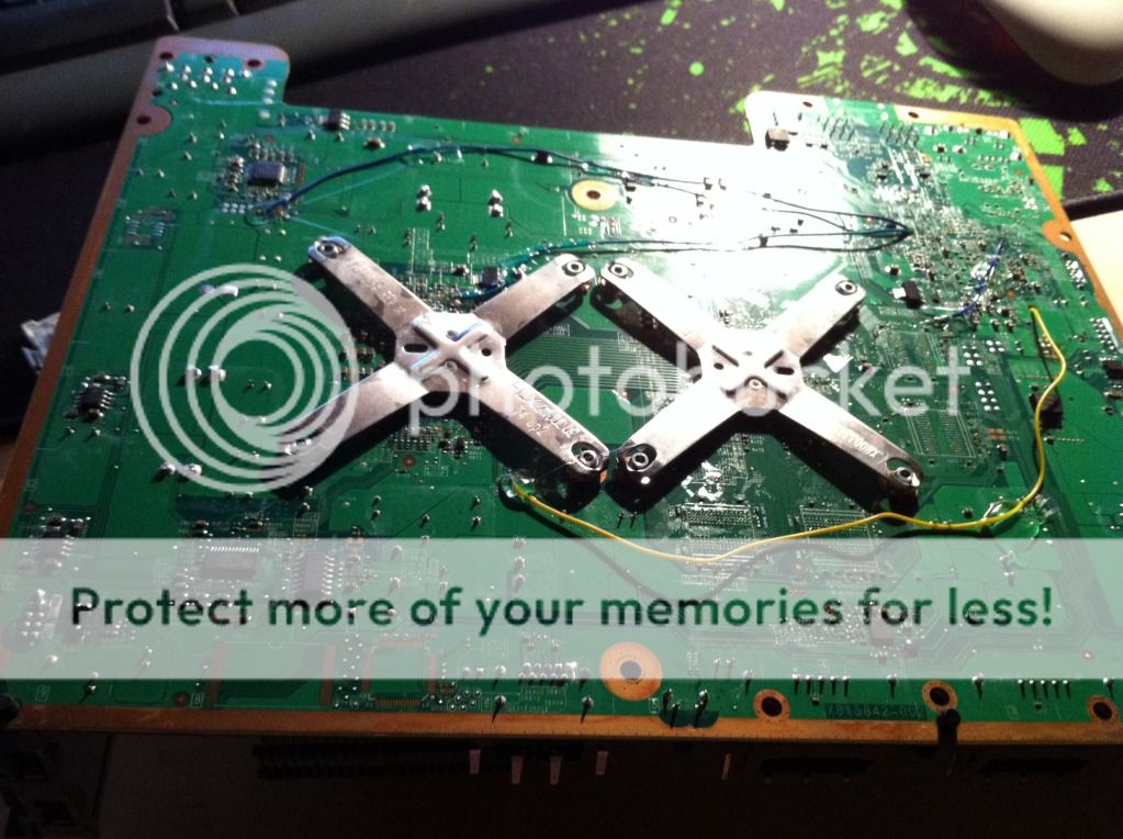

Hi,
i just did a RGH with rev b coolrunner on a 512mb jasper. everything seemed nice and dandy - the thing booted to xell i got cpu key, built an image from 64mb dump flashed it aaaaaaaand.... bam! now it still boots to xell through eject. but when i try to boot normaly it gives me one red light and secondary code of 1023.
as it says on the internetz (llama) that, i quote: "1023 DVD drive not connected, connect DVD drive to boot"
and it is connected + it ejects as it should.... i read elswhere that it was ethernet connectors pins that shorted together. but mine are nice and straight.
the xbox seems to start booting and then crashes. i mean it waits until it gets the glitch signal and then when the first leds blinks (to do the initial "blinking wheel") the xbox throws a red light in bottom right and i can't proceed....
ideas? i need this fixed in the upcomming 7 hours. preferably get some sleep in the midle lol :D

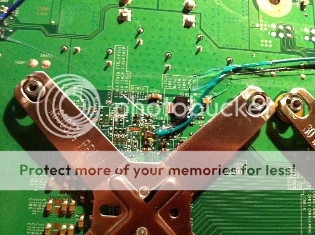

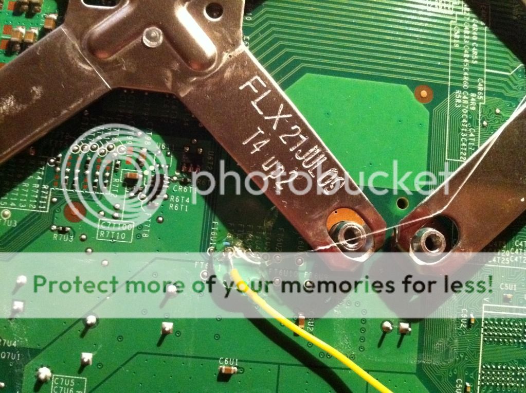

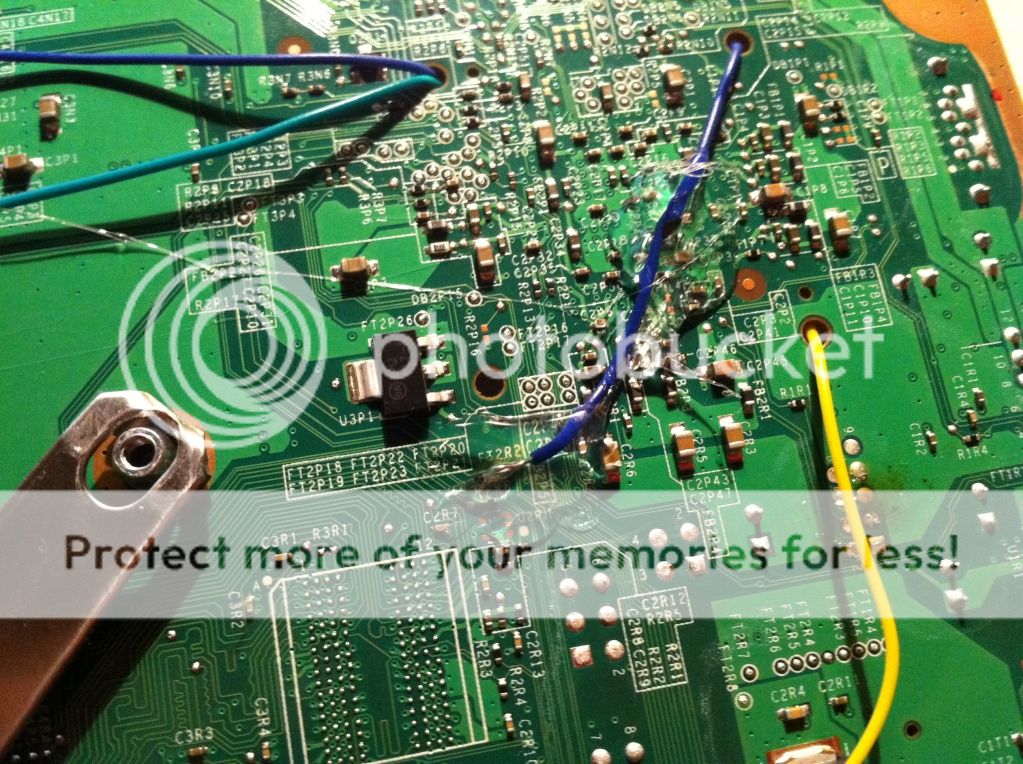

the only point that might be causing problem (in my humble oppinion) is the one near the xclamp (green. pll_bypass) as you can see i have finalized these points because the thing booter super nice into xell.
btw, the CAP is bridged on the Coolrunner if that changes anything....
