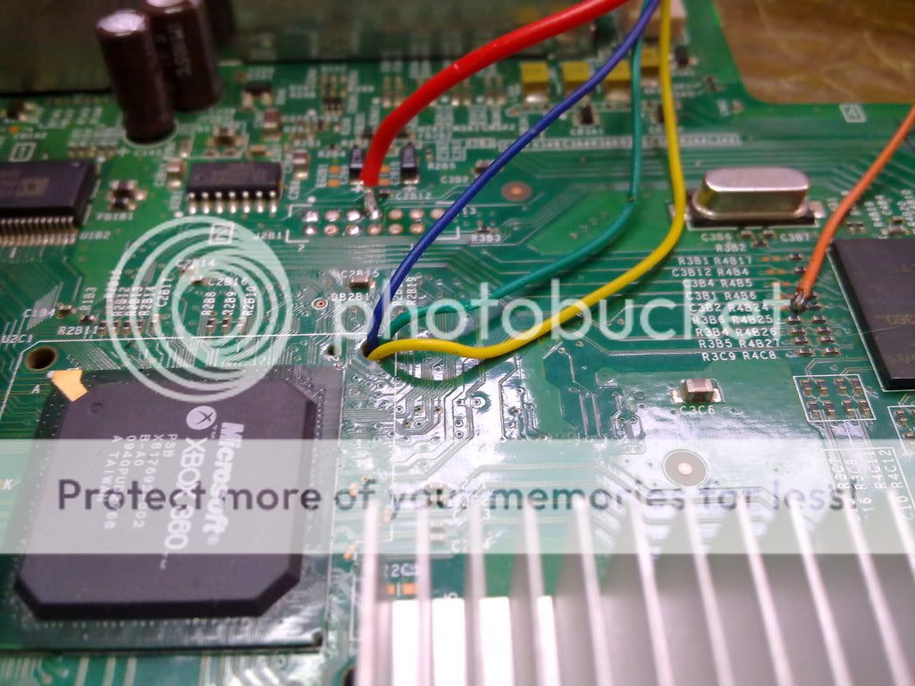

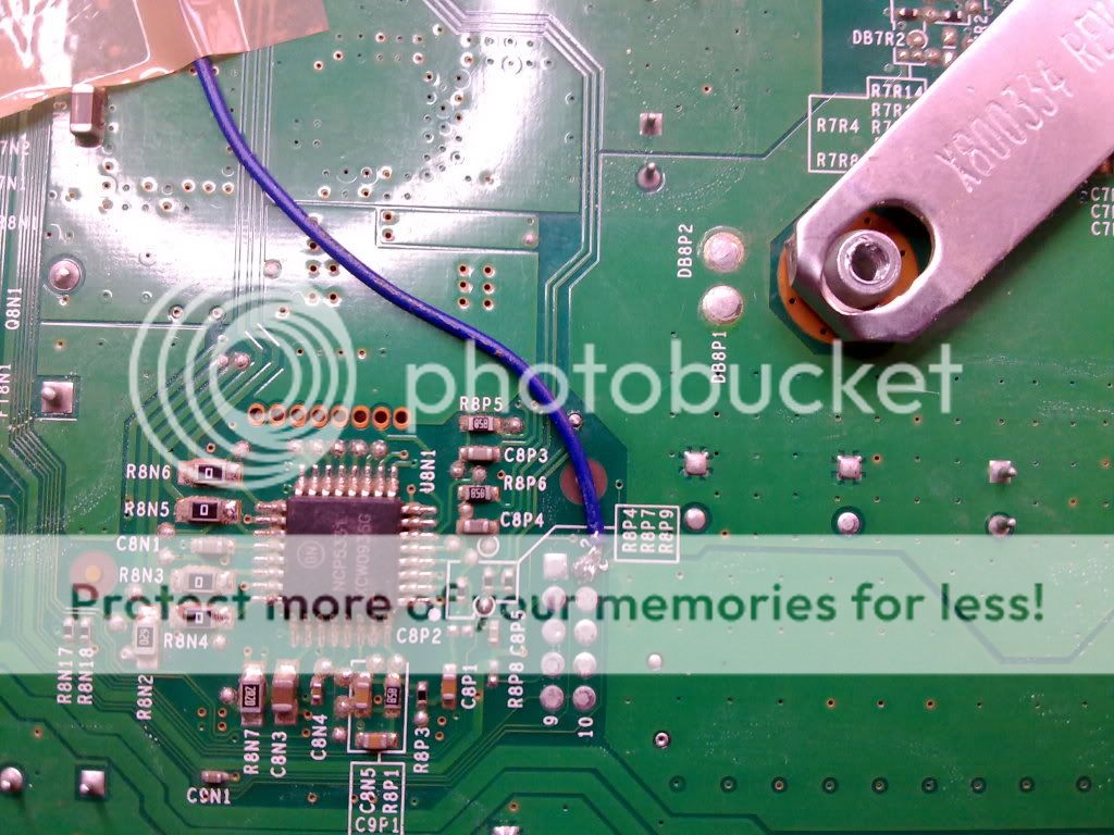

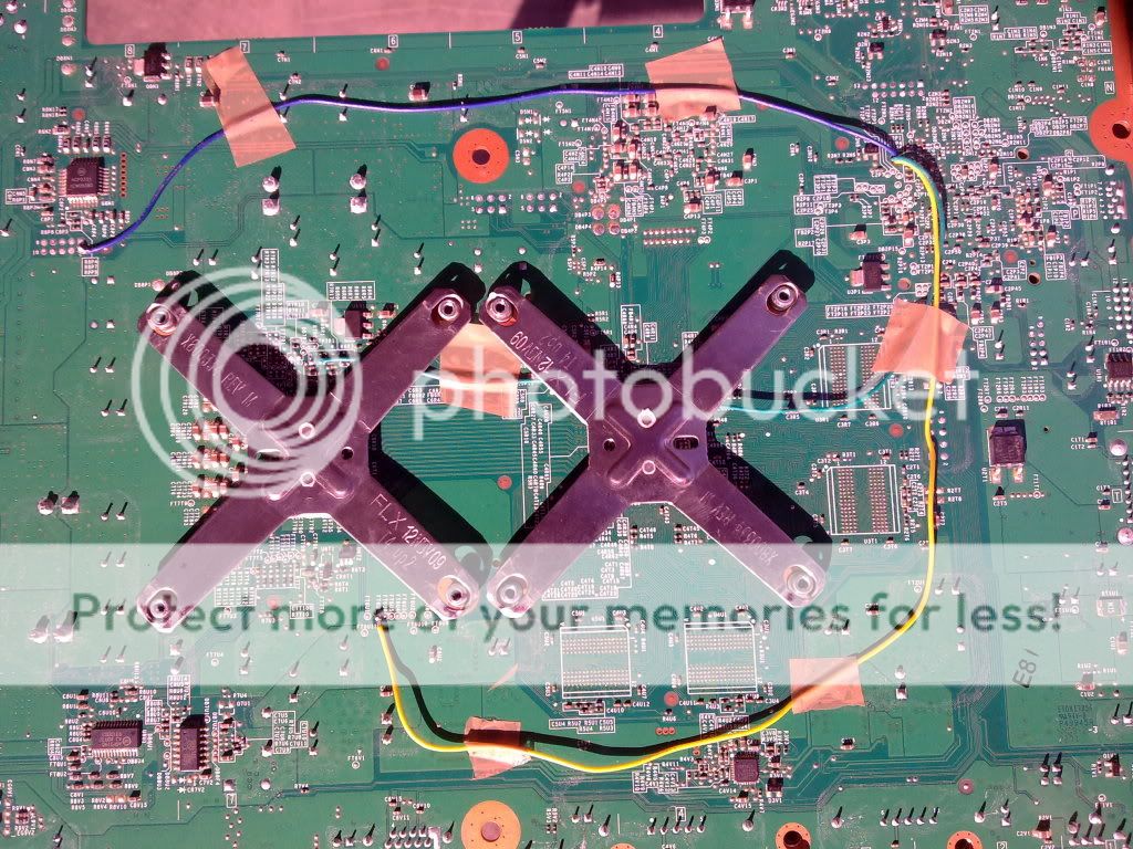

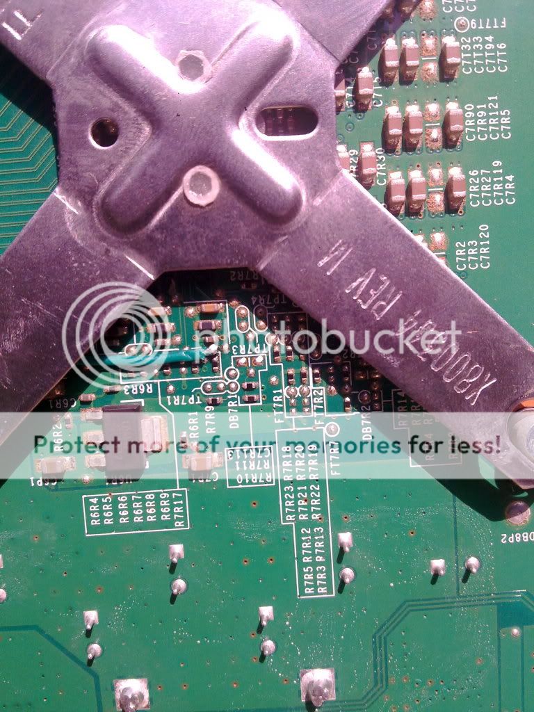

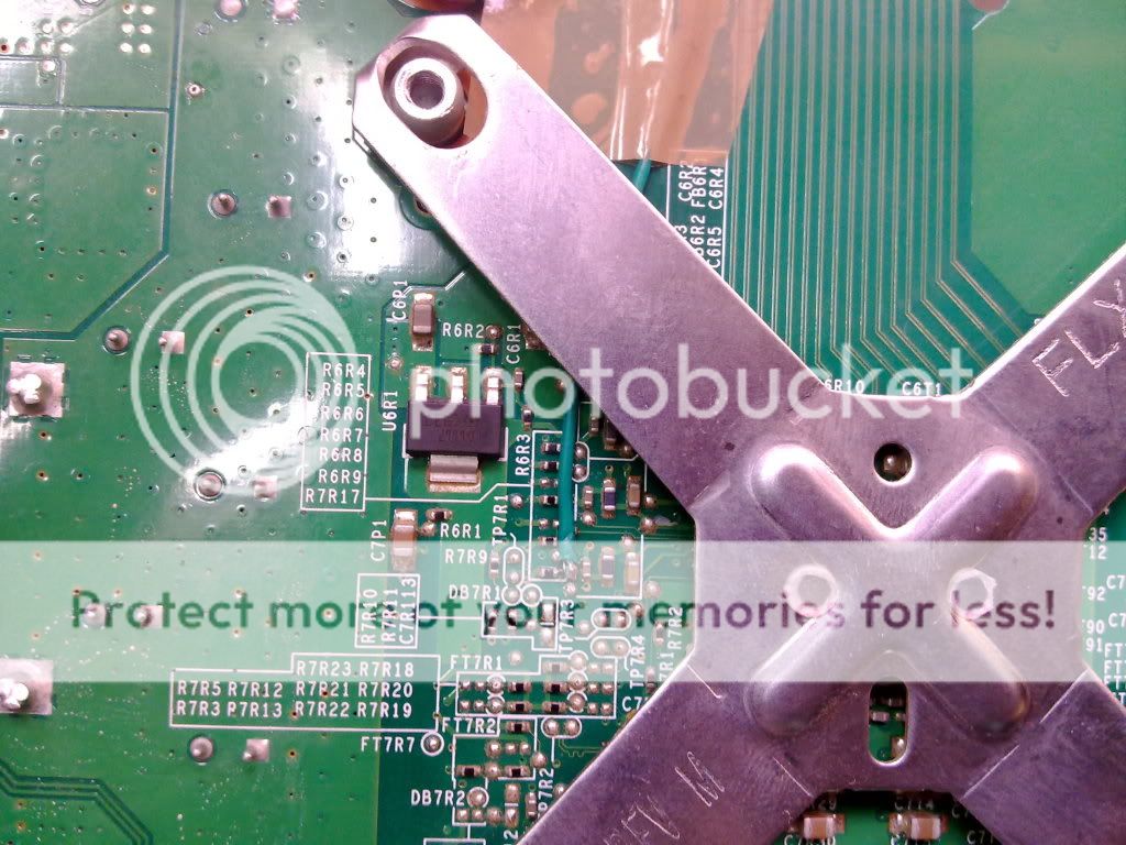

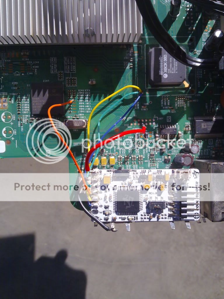

also more deails
Pics
Dashboard on before starting
Motherboard
Programs used
