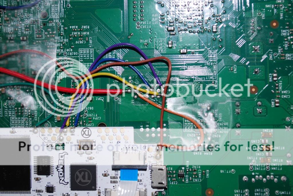

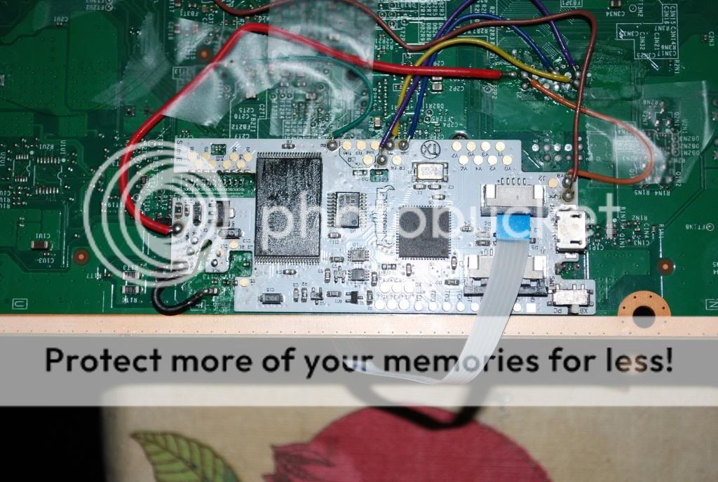

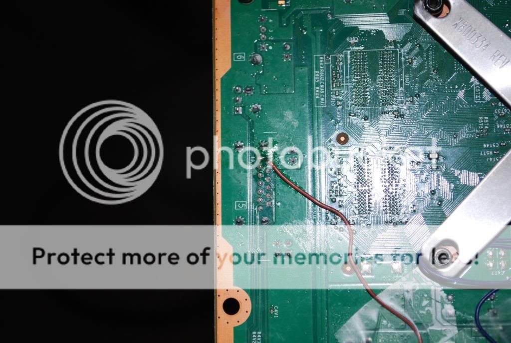

Today, i installed a Demon on a slim console that was previously rghed. I tested the demon before hand and updated it. I installed it and i wrote the original nand dump of the xbox to the demon, to which it booted both the original nand and the glitch image. After that, i wrote the original nand back to the xbox and the glitched image to the Demon. After doing that, i tested the console again and it got Red Dot when booting stock nand and infinitely glitches when on the Demon side. I tried a bunch of things, but nothing works for me. Here are pictures of my install

Fair point, after haveing a better look maybe some of the demon cable which are attached to the nand could do with being a little shorter, also the brown cable attached to the demon looks like it could be touching the orange cable below it.

Alrighty, will shorten up and clean up the cables and routing and post results!
