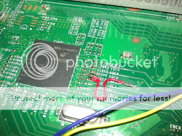

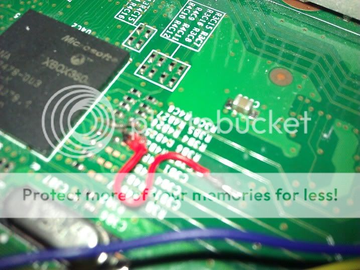

So, I lifted the STBY_CLK pad by accident. :facepalm:
Since this the xbox has not been turning on, I cut the trace and soldered a wire to the place suggested, it still won't turn on. Also the resistors on the two rows above have come off, don't know how. Going to put this down to doing it so late as night, due to the amount of successful RGH's I have done.
That's two consoles which two separate issues now.....

Hmm, well I have a Slim that is hopefully getting fixed, so I really don't want to take stuf off that.
Well if you had one you could taken a risistor off it,
solder it between a wire an than solder it on the mobo.
Thats wath i did and workt for me.
just like you did with the red wire.
Bud then with a risistor solderd on it.

Would this type of resistor work?
DayvG
Apr 26, 2007
473
Gosport, UK
The regular through hole resistors work fine but your best off replacing with a 33ohm 0603 SMD resistor. A quick search on eBay will find plenty.

are you in the uk ??? also if you damaged the mobo so far just trying to do the install then not sure if you are upto smd soldering sorry i dont mean to sound rude just from the look of the repair that you tried to do not very good and them resistors are alot smaller?? again all i am saying is stop and make sure you are really upto the job before you go ahead and run the risk of making it worse

No offence taken, yes I'm in the UK. I got the coolrunner working for a couple of weeks, then opened it and accidently pulled the pad off. Again, the shabby job is probalbly down to me doing it at like 3 in the morning lol.
