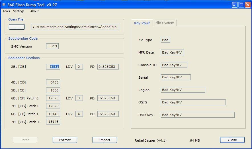

Can you load nand image into 360 flash tool and post printscreen.

load your Nand1 to 360 flash tool and tell us what is shows under 2BL

I got this:
Link To Image
Can you please explain to me what that mean?
That means CB is glitchable and shows no bad blocks, so 2 possible causes eliminated.
