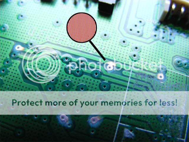

Just use an Exacto knife/craft knife. If you go to hobbyist shops they should have fiberglass burnishing brushes. Its not necessary but makes the job much easier. Try not to expose anything else besides the pads. It increases the chances of shorts.
If you have a pencil laying around (with an eraser tip), you could always glue some sandpaper to the eraser tip. 600+ grit should work well but work slow.
What i usually do is drag the tip of the exacto knife across the pad diagonally untill I can see the shiny copper pad. Change directions when you reach the other end. Do it horizontally, then vertically etc etc. and finish off with a fiberglass burnishing brush. Cut traces using a dremel and engraving tip (0.8mm), Flux and add solder to the pads. Clean flux off with isoproply alcohol pads. Do the same for the LT Switch. 100% perfect every time.

This was very helpful, JOCKz.
Do you happen to have a pic that size with the cuts so I can see how far you go on each one?
Thanks!
And if you do not have time, I completely understand.
I just wanted to get an eye for what it looks like.
Sorry mate all the Lite-on's i've modded have been returned. I have 2 sitting here but cant be bothered pulling them apart. I should be getting a few more next week so i'll post more pics. Have a look on Boxxdr's site, it should give you a pretty good idea.
http://www.boxxdr.com/lohack.html
