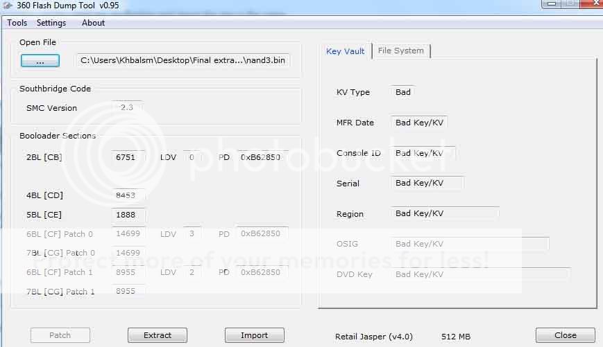

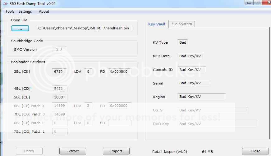

My xbox is 512 jasper i got some bad block error but it does match when compare with nandhealer So i created the ecc file using 360multibulder V7.yes it does boots to xellreloaded page after that i use rawflash_v4 + the freeboot image Via usb to move the bad block but the problem is its nt boot to the dashboard.and all my soldering are fine Here is the img of the bad blocks
Ellsyy
Jul 13, 2011
22
Do you have 360 flash tool?
If so open your nand from before and the nand you are flashing and check this box is the same;
As you can see the one on the right after creating my new nand only has 5 of the fuses blown, so I needed to patch it.
If there is a difference, let me know and I'll tell you how.
Link To Image
This is my original nand through 360 Flash Tool
And these one is the flashed nand 67mb by 360multibulder v7
Anyone can send me an email. Click on my name and choose 'send email' :)
It's not what I asked however - I would be tempted to reflash your image using nandpro:
nandpro usb: -w64 nandflash.bin
