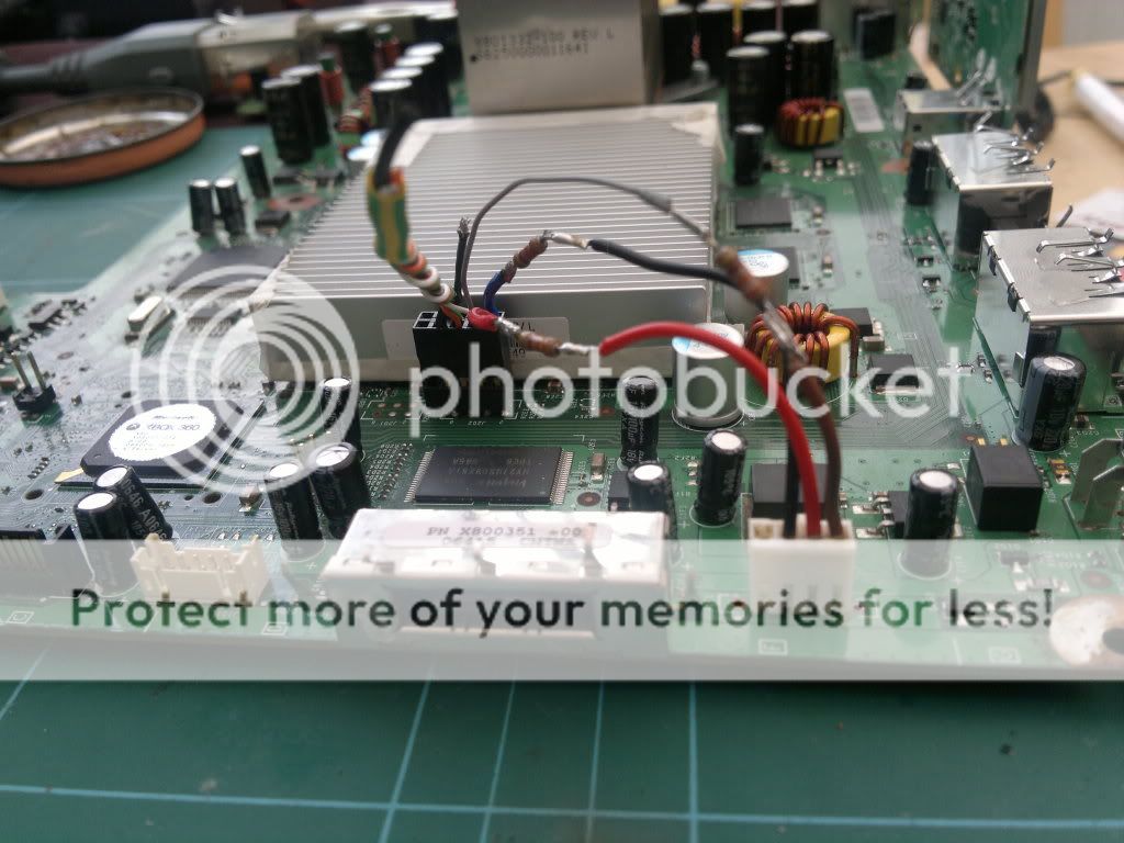

i got a donor nand but i cant connect to it anymore, i plugged it into another jtag and can read from it o.k so my lpt cable and software is o.k, but the xbox does power up with center green light on but then does nothing!.

Oh I see. So the box isn't even recognizing that it's available to write to. Hmm don't k kw what to do maybe try a reattach and post some pics of install. I would really like to get this going for you. But it's hard without images. What all is installed on the board I know LPT cable was removed but is jtag wiring still on

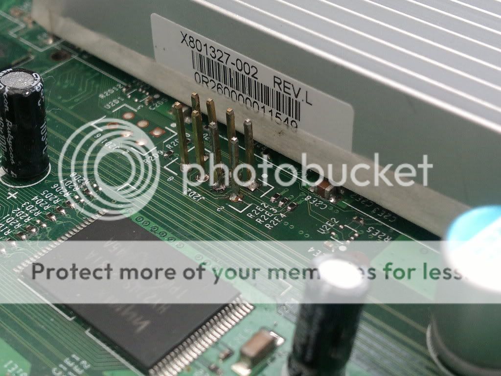

---------- Post added at 00:59 ---------- Previous post was at 00:56 ----------
---------- Post added at 01:00 ---------- Previous post was at 00:59 ----------

I know your console is working. Could be a problem with one of the points under the GPU where the hack takes place.
If you do a search you'll see a post from Martin the points and values it should be.
