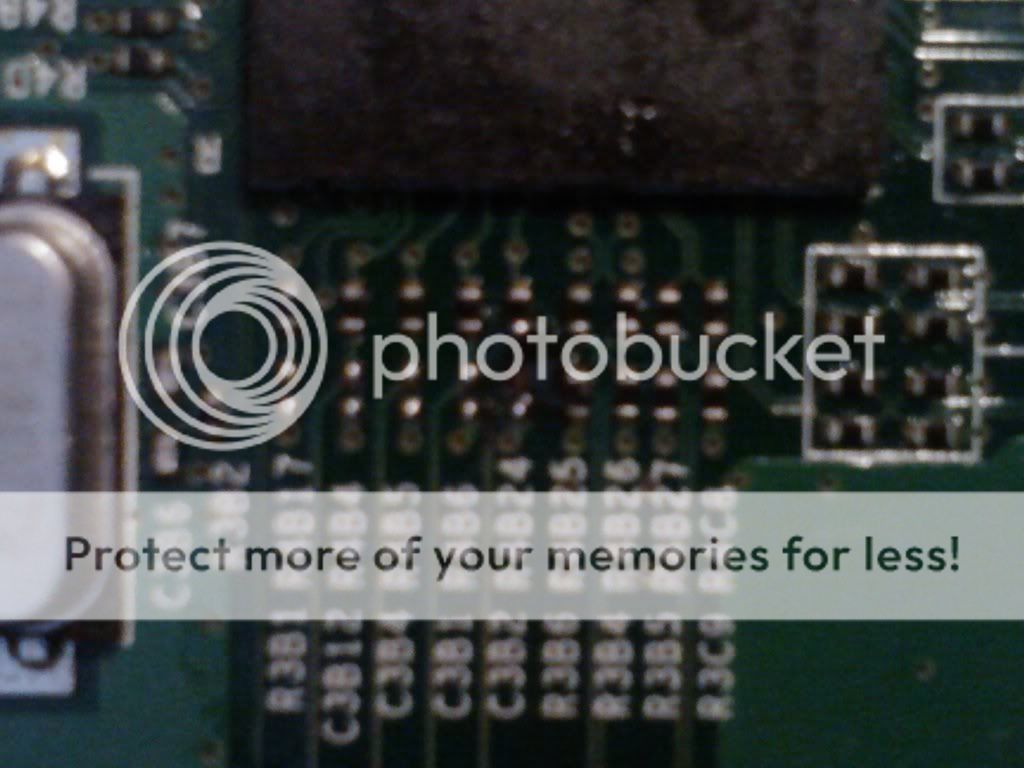

I tried both component and HDMI... I think I found my problem the Orange wire connected to the point near the Hanna chip pulled the little pad when I placed the fan vent back on... The console doesn't power but the cool runner is on. Sucks for me looks like the console is done for!

If STBY_CLK is broken then see these images, Credits to UberGeek.

Now correct me if I am wrong but you will need to repair that trace before the console will boot, not easy but do able.. scrape the trace and solder to the left of the resistor and trace.

and if you mess up the resistor like i did them u can replace it with a 34 ohm resistor the old big kind. i used a 1/4 watt and it worked.

Alright so I would like to update you all on what I have done. I took a box cutter and I
scrapped the trace. Then I applied flux to it, and I took a small piece of wire and cut it to
size and tinned the edges with solder. I then was able to solder it to the board and voila...
Console powers up. I then soldered a longer wire to the back of the console to an alternate
point and I have booted Xell. I am now going to buy a glue gun so I can make sure that
connection stays sealed without moisture or elements getting to it. I will also glue gun my
solder points as well, or do you guys object of doing that?
