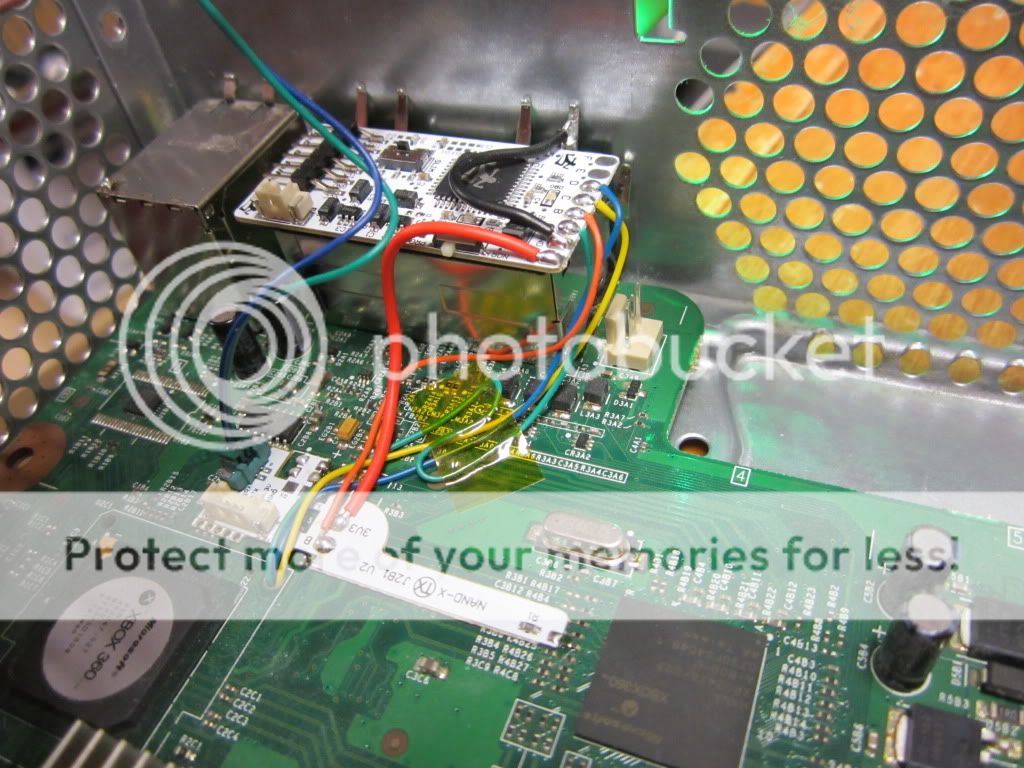

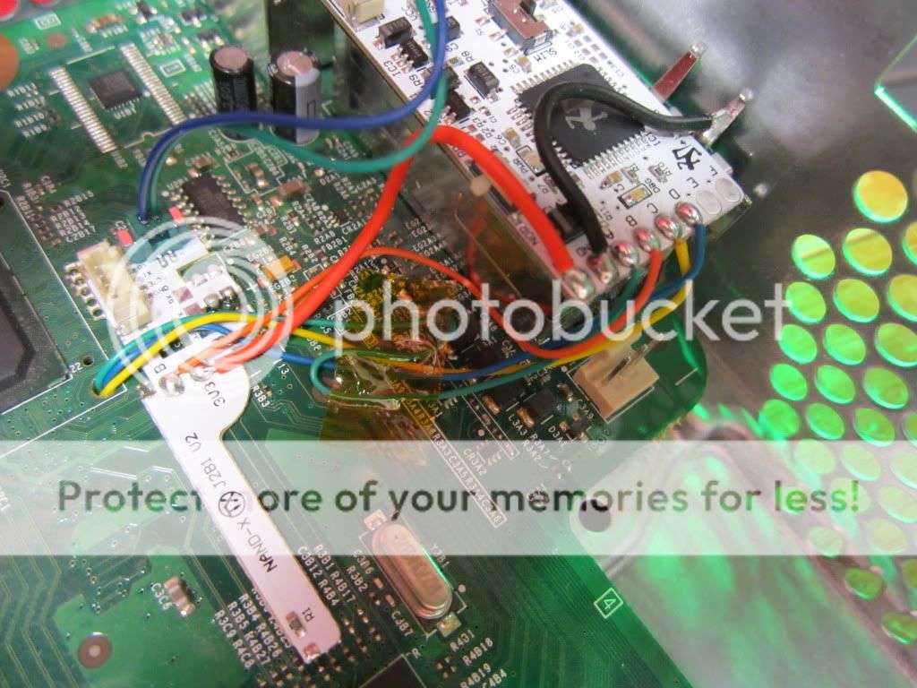

reefz3ro
May 30, 2011
669
Pittsburgh, PA
Dont know if i just got lucky with my zephyr or maybe it will help but it has the same cb and this is how i have it wired/routed
it boots between 5-10 seconds evry time
sorry for poor image quality really need a new camera.
