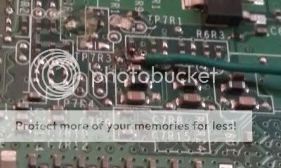

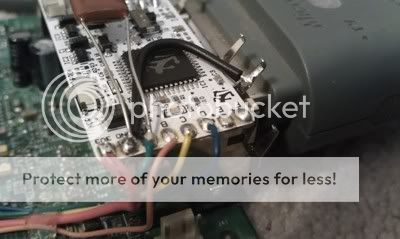

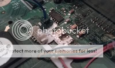

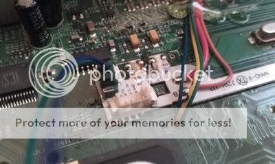

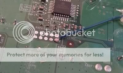

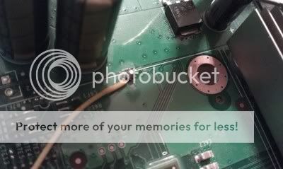

HOLY sh*t! It booted Xell again, once. I was messing around with the wiring, relocating POST_OUT1, and CPU_RST to the points on the top of the board. I powered it up once, no go. So, for sh*ts and giggles, I removed the cap that was across PLL_BYPASS and GND, and it worked, atleast once. So I have the Fusesets now!
---------- Post added at 14:45 ---------- Previous post was at 14:38 ----------
Also, here are some pictures of the install.

Your soldering from what I can see looks fine, you should now have everything you need to build a new nand, just use a donor nand and inject your KV in make and sure the LDV matches in line 7 (count the f's). You may need read some Tut’s on this to get everything correct, you should be able to build one from what you have.
