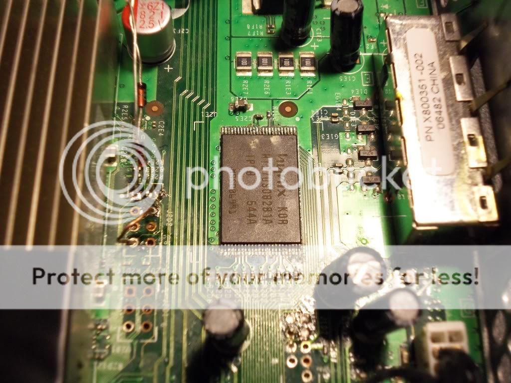

hey guys i picked up a zypher on ebar for like 15 dollars, the guy said it worked fine and had no dvd drive but thats fine as its on the blades dash, so i got it to jtag it and get it running.
heres the problem he said he couldnt read the nand but hasnt really tried hard, lol all the pads were ripped off and some of the traces so i fixed some up and all test good with the multimeter but when i try to read the nand it says cant detect flash controller.
then i noticed that he knocked off the resistor at r1r1
will it read without that resistor? what dhould i replace it with if not?

well i got carried away lol went to transplant the nand and read it that way which was going great untill i had xell loaded on it and went to put it back on the orig board and broke a couple of pins......now i needa learn how to build a complete donor or well how to flash xell to another nand and then build a donor....any ideas?

ok thats what i thought....and can i do this from another board, remove the nand and solder it to this one? and i do also believe my nand x is dead now as i can program coolrunners but it wont read any nand i try (6 diff boxes now)

so heres the update...desoldered the nand and in the process broke a few pins lol so i trashed that one and pulled one from a dead xenon, soldered it to my normal zephyr and flashed xell to it and soldered it back to the jtagable board and got the cpu key and built a donor image, got it all flashed and its running smooth other than 2 problems. one is on hd cables the screen is washed out, its really bright white. and on hdmi its a little darker than normal. two is everytime i boot the console it goes to the new system setup screen and i finish it fine then after a reboot it does it all over again.

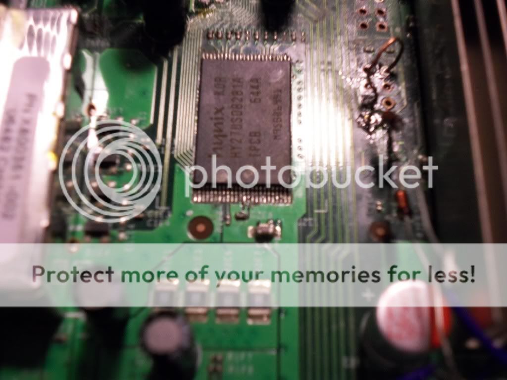

i cant seem to get a clear closeup pic no matter how hard i try with this crappy kodak....i believe there ws something wrong with the image as i had it on 14699 created by bestpigs tool and it would do the new system thing everytime then i used j-runner to bring it up to 14719 and all great now
and idea on how to get a clear pic of the nand?
