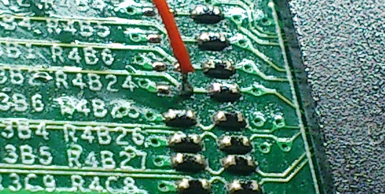

I just received this console:
without the DVD drive. The console boots OK to original dash.
There were some signs of previous RGH2 attempts.
Read NAND - ECC - Wrote ECC - hooked up CR2 rev.c. I had no green pulse. Checked and double-checked the wires, solderings were ok. I've removed the wires and ttried again with kynar wires, same result, no green light. I've used both, blue and double-shielded wire(connected to ground at one end) and CPU_RST cleaners made by myself(680 / 560 / 470 - 1k, 2k, 3.3k in all combinations). I only need to boot xell once to retreive DVD-key
I'm pretty confident that this is not a soldering issue. Sorry about the picture quality
here, the wire seems broken but it's just a picture artifact

Strange issue:
Timing file: RGH2 C, Jumper 1 open, jumper 2 closed, I can see the DBG blink just for a split second followed immediately by RROD 0010, only on C timing file and with jumpers as I said.

SOLVED DBG led issue, I noticed that STBY_CLK point was a little wobbly, I thought that, after many attempts of RGH'ing pad was lifted, so I've soldered the blue wire end to R8C2(the pad before the resistor) and now I have DBG light as it should be. But, only on timing RGH2 C i get more than 6 flashes, all the others stop at 6 exactly(no more, no less). Didn't get to XELL yet, I'll try different combinations of wires / cleaners.
I was wondering, has anyone managed to get to XELL on an RGH2 Zephyr?
